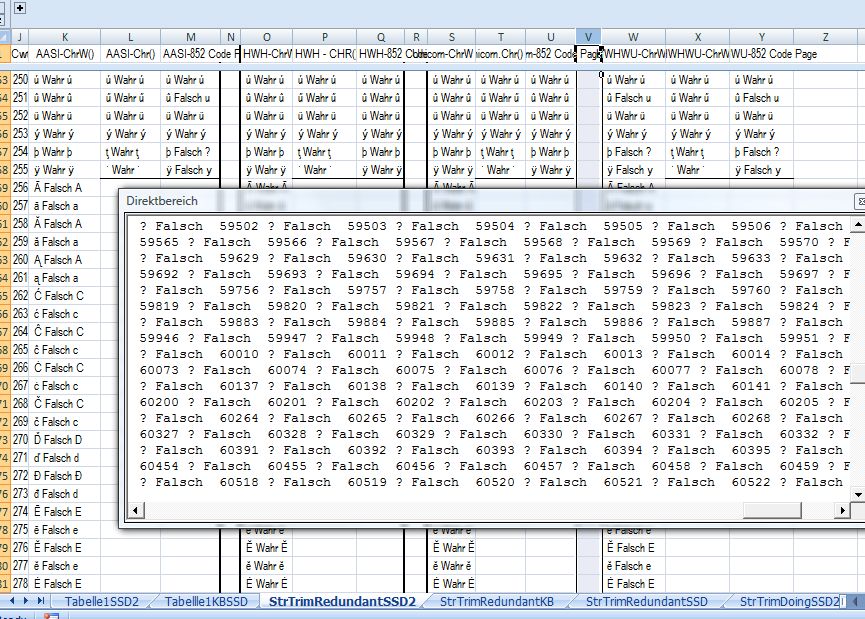

    Spreadsheet for results
    We will exclusively use the spreadsheet for results, since some initial investigations suggests that the spreadsheet reproduces a very large number of different characters, so we can most likely assume that no extra complications are raised as a result of pasting out into a spreadsheet. Similarly we will assume that VBA variables hold accurately all characters so that a simple comparison of a variables holding the inputted and outputted character will gives us an accurate indication of if the character has changed. We can then list results thus:
    A True A 1
    a True a 1
    ā False a 1
    https://i.postimg.cc/Bt9cqfc6/Str-Tr...ng-results.jpg
    https://i.postimg.cc/0QsYSvdF/A-True-A.jpg
    (, where I am also including a number for the length of the output, 1 in this case. **The significance of that will be apparent later )

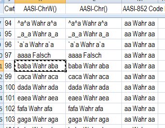

    _ secondly we do the same thing but with StrTrim arranged to do something, pseudo like
    StrTrim(Chucky(x) & "a" & Chucky(x) & "a" , "") - > should be "a" & Chucky(x) & "a"
    , to make that a bit more clear, let's say Chucky(x) is Chr(98) . ( or ChrW(98) ) , which is b , then
    StrTrim(Chr(98) & "a" & Chr(98) & "a" , Chr(98)) - > should be "a" & Chr(98) & "a"
    StrTrim(Chr(98) & "a" & Chr(98) & "a" , Chr(98)) - > should be "a" & "b" & "a"
    StrTrim(Chr(98) & "a" & Chr(98) & "a" , Chr(98)) - > should be "aba"
    StrTrim("baba" , "b") - > should be "aba"

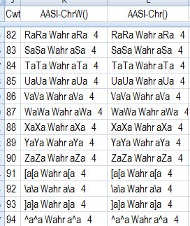

    Correspondingly if the function does as it is intended, then our results will be
    baba Wahr aba
    https://i.postimg.cc/Vk1Vz9nj/baba-True-aba.jpg
    The True result will be based on the last 3 characters on the left being the same as the (first**) 3 characters on the right. I also include in some of these results again the length of the character set on the right. You can see for the first time in this next screen shot something screwy, as 4s are showing where we should see 3s. More to that again later
    https://i.postimg.cc/Wzwm71wx/Len-4-...d-of-Len-3.jpg

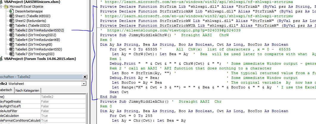

    Typical codings discussed in the previous post
    Here are just two sample codings from the workbook.
    The first coding uses the straight AASI version of the StrTrimA( , ) , and tries trimming nothing from as single character, or rather it loops through the entire ChW(x) list of characters , x = 0 - 65535 , attempting to trim nothing from it. The results it presents in column K https://i.postimg.cc/m2GW2cCN/Str-Tr...n-column-K.jpg
    Coding is in file the worksheets object code module, StrTrimRedundantSSD2
    ' https://learn.microsoft.com/en-us/windows/win32/api/shlwapi/nf-shlwapi-strtrima
    Private Declare Function StrTrim Lib "shlwapi.dll" Alias "StrTrimA" (ByVal psz As String, ByVal pszTrimChars As String) As Long '  '  Straight AASI          -   we'll be passing vb string to api
    Private Declare Function StrTrimTrickAW Lib "shlwapi.dll" Alias "StrTrimA" (ByVal psz As Long, ByVal pszTrimChars As Long) As Long '  Trick _ Half way house -  we'll be passing the StrPtr to API
    ' https://learn.microsoft.com/en-us/windows/win32/api/shlwapi/nf-shlwapi-strtrimw
    Private Declare Function StrTrimTrickW Lib "shlwapi.dll" Alias "StrTrimW" (ByVal psz As Long, ByVal pszTrimChars As Long) As Long '   Full Unicorn's Bollox  -  we'll be passing the StrPtr to API
    Private Declare Function StrTrimTrickWUA Lib "shlwapi.dll" Alias "StrTrimW" (ByVal psz As String, ByVal pszTrimChars As String) As Long '   we'll be passing vb string to api
    '  https://eileenslounge.com/viewtopic.php?p=324039#p324039
    Private Sub JimmyRiddleAChrW() '  Straight AASI   ChrW
    Dim Ay As String, Bea As String, Boo As Boolean, Cwt As Long, BooToo As Boolean
        For Cwt = 0 To 65535 '      All  ChW(x)  list of characters , x = 0 -  65535
         Let Ay = ChrW(Cwt): Let Bea = Ay  '  Bea  will be used later to comparte with what  Ay  becomes after used
        Debug.Print "  " & Cwt & " " & ChrW(Cwt) & " ";  ' Some immediate Window output - genrally less useful in such experiments as the VB Editor and Immediate window do not do  WUnicode  so that adds another confusion. I ust the Excel Spreadsheet instead for viewable output --###
        Rem 2 ' call an AASI ' API function that does nothing to a character
         Let Boo = StrTrim(Ay, "") '                     ' The typical returned value from a function does not give a typical direct result. In this case it tells us if anything was trimmed.  We do not need this result
        Debug.Print Ay = Bea;                            ' Some immediate Window output
         Let BooToo = Ay = Bea                           ' The original variable  Ay  now has possibly overwritten in it  a new value, or not. Investigating this is  one of the purposes of this coding
         Let Range("K" & Cwt + 3 & "") = " " & Bea & " " & BooToo & " " & Ay  ' I use the Excel Spreadsheet for output as it appears to have no issues with reproducing accurately many thousands of different characters. -------------------------------------------------------------###
        Next Cwt
    (The Immediate window results are of limited use in such experiments as the VB Editor and Immediate window do not do WUnicode so that adds another confusion. In further experiments we will mostly ignore the Immediate window or any other typical VB Editor debugging tools )

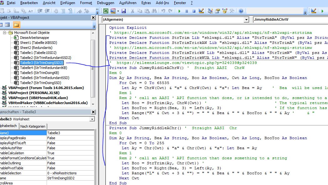

    The second coding example is the corresponding straight AASI approach with the attempt to get the StrTrim to actually do a trim
    I give it 4 characters, for example
    baba or caca
    , trimming correspondingly for those two examples with
    b or c
    , using arbitrarily the character a as a filler. So in those example the results would be expected of
    aba or aca
    Coding is in worksheets object code module StrTrimDoingSSD2
         Let Ay = ChrW(Cwt) & "a" & ChrW(Cwt) & "a": Let Bea = Ay    '  Bea  will be used later to comparte with what  Ay  becomes after used.  Ay  will itself possibly change on  "it's journey through"  the  StrTrim  function
        Rem 2 ' call an AASI ' API function that does, or is intended to do, something to a string
         Let Boo = StrTrim(Ay, ChrW(Cwt)) '                           ' The typical returned value from a function does not give a typical direct result. In this case it tells us if anything was trimmed.  We do not need this result, although we will check it sometimes to see if it matches the apparant results
         Let BooToo = Right(Bea, 3) = Left(Ay, 3)                     ' If the function has done as intended, which is to trim of the  ChrW(Cwt)   then we expect the three right most characters on the original 4 character string to look like the returned results, which are overwritten into the original variable,  Ay  , (but there is a subtlty as we may expect an invisible  Chr(0)  on the end of the output, so we only compare to the first 3
         Let Range("K" & Cwt + 3 & "") = " " & Bea & " " & BooToo & " " & Ay '     & "       " & Len(Ay) & "   " & Boo ' ' I use the Excel Spreadsheet for output as it appears to have no issues with reproducing accurately many thousands of different characters.
        Next Cwt
    Private Sub JimmyRiddleAChr() '  Straight AASI  Chr
    https://i.postimg.cc/SKJmDYf9/First-...-something.jpg

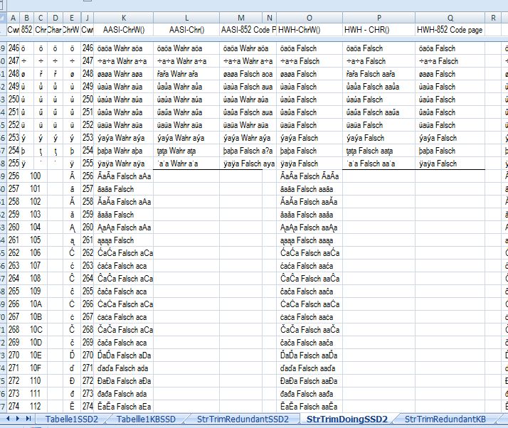

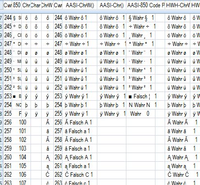

    Some initial observations and conclusions
    Some of these conclusions and observations may change as time goes on and I try many different computers, but provisionally, as notes to possibly come back to and update
    The character lists used in my experiments
    The VBA ChrW( ) function seems to give a consistent list across different computers
    The VBA Chr( ) and Excel CHAR( ) give identical results on any computer. (So from now on observations for the Chr( ) also apply to the CHAR( ) )
    The Chr( ) as expected is always the same characters across the 0-127 (ASCII) range. Above 127 the characters got from Chr( ) can vary on different computers. They do not seem to match the characters from the published tables based on the code page I obtain from chcp in PowerShell . They wouldn’t. … interrogating the code page from a (DOS) command such as chcp gives you the MS-DOS code page, not the windows code page .... You need to look at the GetACP API call The match with the characters from the relevant windows code page and Chr(x) is then the same ( https://www.excelfox.com/forum/showt...ll=1#post24947 )
    Observations for the StrTrim doing nothing to a character, (or maybe not actually doing anything to a character – subtle different…. Maybe….)
    Some conventions for these observation musings:
    "OK"
    If something is "OK", it means the character fed in via the variable, Ay , seems to be the same as that coming back in that variable. So this means results like
    Ê Wahr Ê ( Wahr on my mostly German computers is True in English )
    "Wonky"
    "Wonky" means I may not always get the OK results, but that at this stage I do not have enough results to be more precise.
    "Don't work"
    Something like "don't work" / not work, or similar means I mostly get a mismatch with what comes out compared to what goes in, but once again, at this stage I can't be more precise
    It may be easier to "work backwards"…
    The full WUnicorn
    The full WUnicorn appears to return the character it gets across the full 0 - 65535 decimal (Hex FFFF ) code point range
    The half way house WUnicorn
    The half way house WUnicorn is OK up to 127. From 128 to 255 it can be a bit wonky. Above 255 you may only occasionally find the odd Wahr ( True ) match to in and out
    The half way house ASII
    This appears to give the same "perfect" results as for the full WUnicorn for the case of StrTrim doing nothing to a character, (or maybe not actually doing anything to a character)
    The straight ASII
    Based on the first occurrence I saw of this, with the StrTrimA I was expecting this to not work above 255. At first glance this appeared to be the case. However as a result of looking more carefully, and also trying out a lot of computers I was able to see some anomalies , above 255 and also below 256
    _ For the Chr( ) characters the straight ASSI works (True result) across the 0-255 range
    _ For the ChrW( ) the story is interesting. These anomalies are such that not only do we see it working sometimes above 255 but also occasionally not working below 256
    Over the ASCII decimal code point range, 0 to 127 it mostly works, (True result)
    Going up to 160 it is mostly False
    From 160 to 255 they can all be True on a computer, or I have seen it approximately 50 50
    Above 255 to approximately 400 you can get just a few correct on one computer or about a third on another

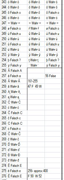

    Here is an example for a computer with windows code page 1250
    https://i.postimg.cc/0jFgS1ZG/Straig...D2-CP-1252.jpg
