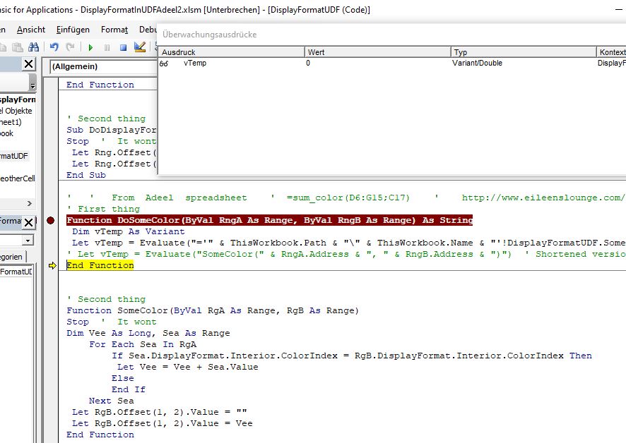

    What’s going on? Here is my take on it, - how I got the slightly modified version of Rick’s discovery
    Back to the start of Rick’s Post : Rick reported a report, which was a report of the discovery that hovering over a hyperlink in a cell ( where the first argument of the hyperlink function was a Function ) caused the firing of the Function
    Like this: Put this in a normal module
    Function SayHello()  '  '  In any cell type something of this form  ( You will need to change the path to suit where you have yopur workbook )    =HYPERLINK('F:\Excel0202015Jan2016\ExcelFox\BlogsBugs\BugsNovelShortTips\UDFinCellChangeOtherCells\UDF to modify other cells.xls'!Module1.SayHello(),"Hover over this cell to say Hello")
    ' Stop '     This  Stop  will only work if you navigate to the cell using arrow keys, and then hit  Enter
     MsgBox prompt:="Hello"
    Now type _ =HYPERLINK(SayHello()) _ in a cell, and then (after hitting Enter) hover over the cell with the mouse

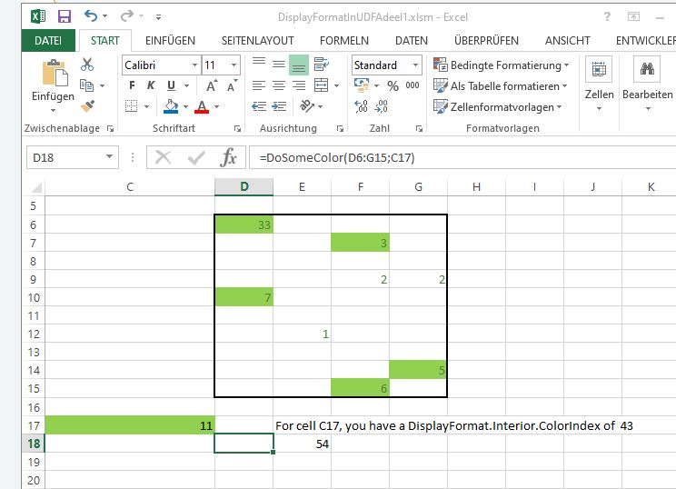

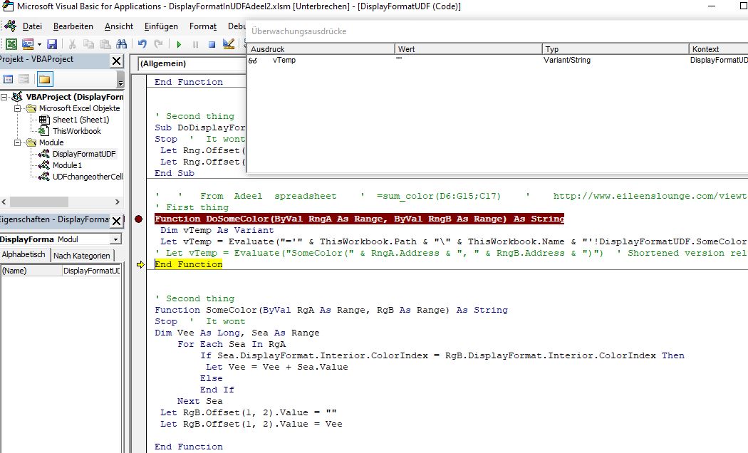

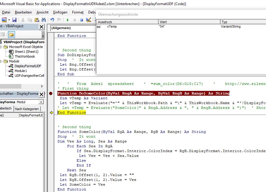

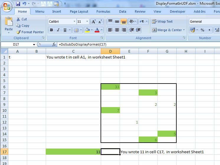

    P You did 2 Ps in column C
    Rick’s example
    The main difference, ( and the only significant difference in my version of Rick’s coding ) is that here there is no use of the Excel Hyperlink function
    Put these macros in a normal code module
    '   Put these macros in a normal code module.  Now put this UDF calling formula, =DoCool(B3) , in a cell, say, C3…  The procedure, TooCool(arg ,   ) , is the one used in the  Evaluate "Procedure to do stuff to other cells"   code line. That procedure gives us the output in , that is to say changes the cell value of , J3
    ' The second part of the function below is conventional UDF stuff.  The first part is the bit what lets us change values in cells other than that in which our UDF is placed in the worksheet

    I remove Adeel’s formula in his cell D17, ( {=sum_color(D6:G15;C17)} ) and I replace it with =DoSubDoDisplayFormat(C17)
    It seems to then give similar results to what I expect. All is well: the formula in D17 writes something in cell E17 if you edit cell C17

    That seems to give the correct result of 54
    ( For comparison, see the results of 54 here:
    http://www.excelfox.com/forum/showth...ll=1#post18404
    Share ‘DisplayFormatInUDFAdeel1.xlsm’ https://app.box.com/s/5nvqh5r8pggc11ulz4lti3yhk39b9wda

    Dim vTemp As Variant
    _ Let vTemp =__ Evaluate("Do something")
    I am not sure what generally will be returned from the second thing to the first thing, in my general arrangement: For all I know at this stage, things might get lost in some virtual space and I will get nothing!! – after all one of the main things behind the general solution is to somehow separate things which are normally together, but for that reason cause conflict problems.
    So

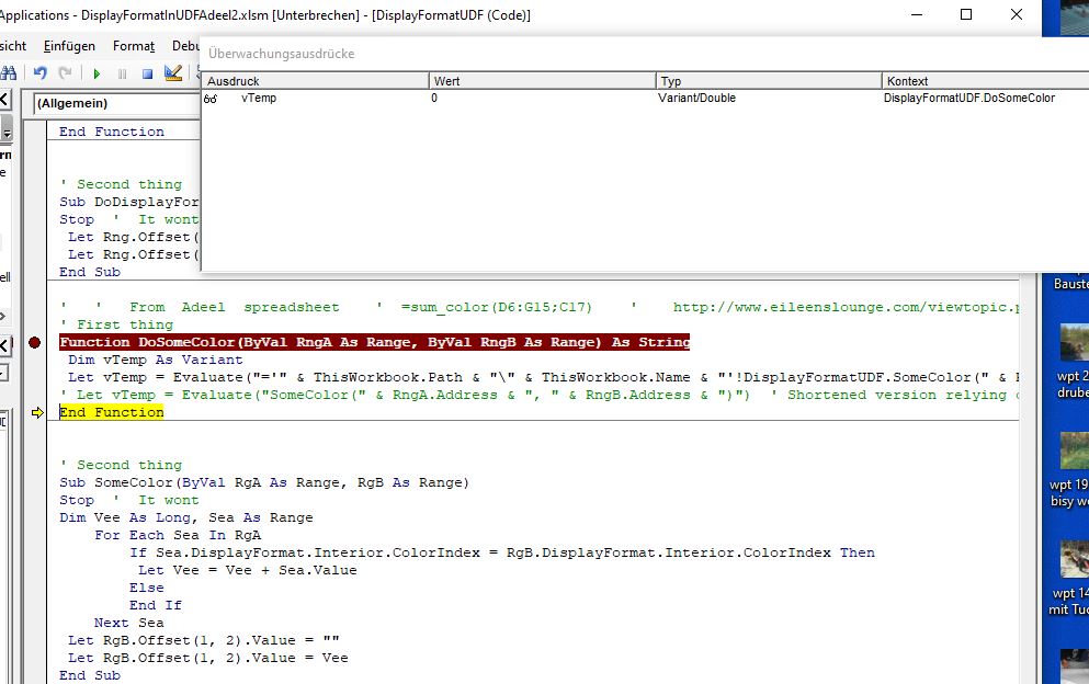

    Initially, just out of interest, I will make just that one modification , and see what happens. All I am doing there is investigating if Evaluate is giving me anything back at all. In the current situation the Evaluate seems to be kicking off the second thing which is a simple sub routine which does take arguments, but is not intended to give anything back. So the first guess is that vTemp wont get changed, … but I was wrong:
    I set a watch on vTemp , and clicked a Stop in the left margin so as to then step debug F8 mode through the first thing, and had a look:
    So it seems to be returning a Double of value 0 into . I don’t know what the significance of that is. As I already said, I am not sure what generally will be returned from the second thing to the first thing, in my general arrangement.
    _.________________________
    Next step is just to change the second thing from a sub routine to a function. The result I see in vTemp is the same as the last time.
    Once again, I don’t know what the significance of that is, but one thing to note is that by default, because I specified no function type, I am effectively doing the second thing like
    Function _____________ As Variant
    _.____________________________________________
    Next experiment is to give the first thing function a type, As String
    That seems to change the returned thing to an empty string. Once again I am not sure what is going on here, somehow a nothing or empty or zero value is wanted to be returned.
    But what is slightly encouraging is that I am influencing what does come back.

    It is rather a shot in the dark, this next step: a first attempt now, to include the code line that assigns the final wanted result to the function, which in conventional function use, is always needed to make the function return something.
    If I am lucky, this will get caught somehow by the Evaluate in the first thing
    Bingo! It seems to have worked. A lucky break I guess, Lol.
    I am interested in thinking a bit more about what is going on here, so I will leave this post for now. Possibly I will come back later.
    In the next post I will finalise the solution which luckily seemed to come out quicker than I expected.
