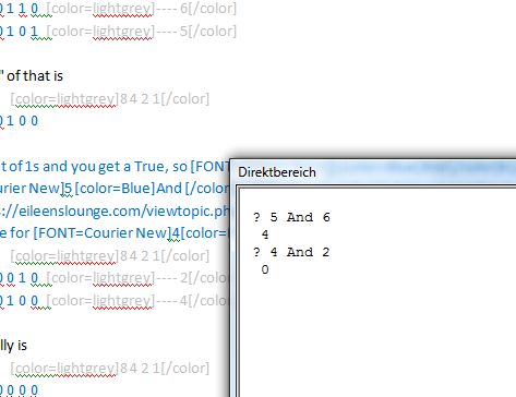

    The second function is sound. – Just to review that: The basic idea, as Hans said , is that in a VBA If … And … Then with two numbers either side of the And , the first thing to do is convert the two numbers to binary, and then, do a bitwise And
    , - just for convenience show them in the same vertical plane…..
    Example:
    6 And 5
                8 4 2 1
    0 0 0 0 0 0 0 1 1 0  ---- 6
    0 0 0 0 0 0 0 1 0 1  ---- 5
    The "result" of that, according to the bitwise comparison, is
                8 4 2 1
    0 0 0 0 0 0 0 1 0 0
    Any amount of 1s and you get a True, so 5 And 6 is True. ( The actual result of 5 And 6 is what that last binary number is in decimal which is 4, but anything other than 0 is True )
    Do the same for 4And 2 and the result is got from this
                8 4 2 1
    0 0 0 0 0 0 0 0 1 0  ---- 2
    0 0 0 0 0 0 0 1 0 0  ---- 4
    , which finally is
                8 4 2 1
    0 0 0 0 0 0 0 0 0 0
    That is 0 in binary or decimal
    https://i.postimg.cc/hvzXKctd/5-And-6-4-And-2.jpg 5 And 6 4 And 2.JPG
