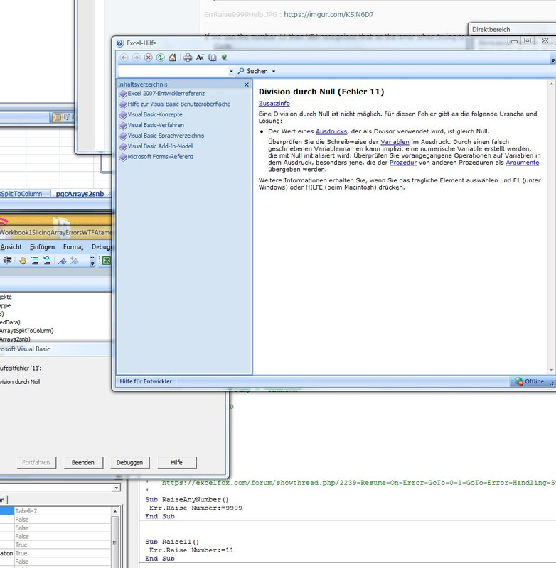

    If we use the number 11 then VBA recognises that as the error when trying to divide by zero, and adds appropriately the description
    Sub Raise11()
     Err.Raise Number:=11
    ErrRaise11Help.JPG : https://imgur.com/tL6uvxN https://i.postimg.cc/R0gz6NNm/Err-Raise11-Help.jpg

    A few Miscellaneous points that might have been missed, or not explicitly stated
    Finallly….
    On Error GoTo 0 “works” in both normal and aroused states .. but
    An error handler can be replaced in normal state without using On Error GoTo 0
    _ If we have an error handler enabled but not active, then we know that On Error GoTo 0 will take us back to the default VBA error handling situation. That code line removes or disables or unplugs the error handler. So just to be clear: On Error GoTo 0 will also remove the error handler from VBA’s memory of it even if the error handler is active and has put us in the aroused exception state/ given us an erecting. So if the On Error GoTo 0 is used in the aroused exception state, then after a resume or On Error GoTo -1 , we will go back to the default VBA error handling situation
    What may not be obvious or intuitive is that in the inactive state, we can effectively replace the error handler with a new one by passing either a On Error Resume Next or On Error Resume LabelOrLineNumber error handler statement code line
    Ending a code effectively does On Error GoTo -1 and On Error GoTo 0
    As far as errors are concerned, then , at least theoretically , the ending of a routine removes the exception and returns error handling to the default VBA error handler. ( There are occasionally reports that after occurrence of errors, a full system restart may be advisable due to some bugs resulting in “something being left over” after an exception has been raised and theoretically cleared )
    On Error GoTo -1 followed by a resume:
    Probably not of much practical use: just an observation. As noted, the resumes effectively do a On Error GoTo -1 . There would not be a lot of use in including that in the error handling code section if you were then going to use any of the resumes.
    But if you did then, curiously the resumes no longer take you to where you might expect: they all take you to the On Error GoTo -1.
    In the demo code below, without the On Error GoTo -1 , any of the resumes will allow for another try of the formula, with a modified value of the variable Destrominator, which should work due to us adding a value which would mean that if it had been zero, then the addition of 1 will prevent it from being zero for the next try. However the On Error GoTo -1 causes any resume to go to the On Error GoTo -1 code line

    resumes “work” in the procedure that they are in.
    If an error occurs in a called routine or function, then the call line is treated as a single line: the resuming will take place just before or just after the call line or at the specified line in the main code. To allow error handling within the function at the error occurrence, an error handler must be placed within function.
    The first code below to demo how resume works in the case of a called routine , only has an error handler in the main code, but the error occurs in a called routine.
    Resume Next is used at the end of the error handling code section in the main routine , which means we resume just after the called routine, and never get to the end of the called routine.
