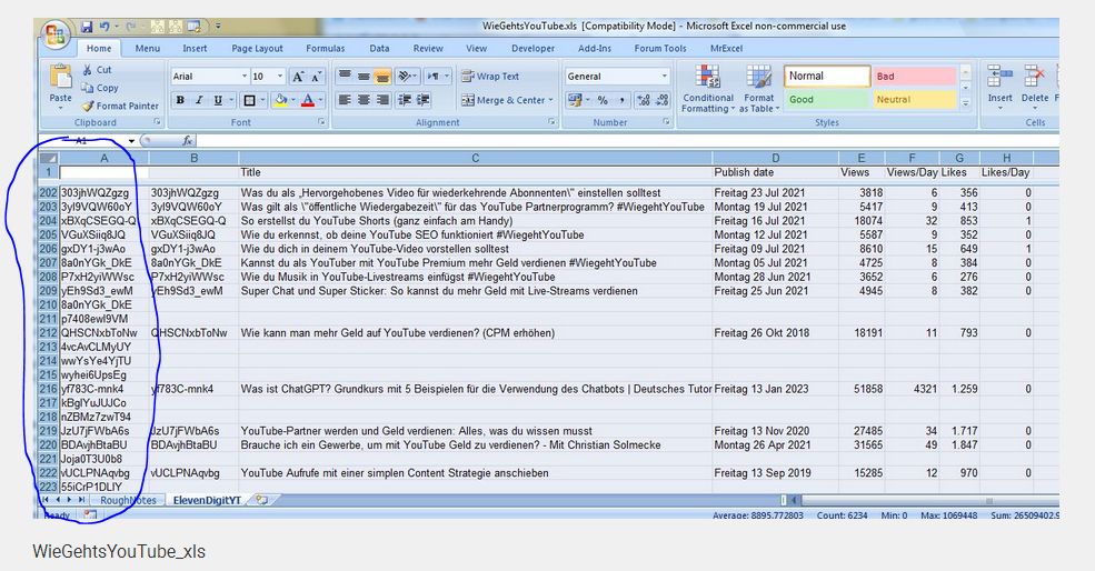

  3. #93
    9,313
    Part 2
    Get the 4vcAvCLMyUY type bit for use in like https://www.youtube.com/watch?v=4vcAvCLMyUY
    I decided to get out all 11 digit unique YouTube bits ( like WDCmlmylNm8 ) you have in a typical YouTube video link, like https://www.youtube.com/watch?v=WDCmlmylNm8
    I find by inspection that there seems to be all these 11 digit unique YouTube bits, (sometimes duplicated**) in some text ending with like hqdefault.jpg. So that is what is looked for, then a bit of text manipulation is done to pick out the 11 digit unique YouTube bit
    I used a macro like this next one, to get all the 11 digit bits from the 9 files got in the last post.

    That code above checks for duplicates of that 11 digit bit in each text file**, but there may be duplicates for the list from each text file as I click a bit above the last link, say on 76th link ,rather than the typical last 79th link, ( if I clicked on the 79th link I would get the unique 11 digit bit for the 79th video twice from the first two text files, by clicking on the 76th link I will get in both the first two text files the 11 digit bit for the 76th 77th 78th and 79th )
    That outputs to a spare sheet.
    For now I manually copy that output 9 times and stick it all in column A of my main file, WieGehtsYouTube.xls ( https://app.box.com/s/97fnm2hhhbiwcnz4nte700pp9sqy79uy ).
    (There are a few extra videos that seems to be advertisements or some video he recommends from someone else. Doesn’t matter – its obvious usually from the title wots wot. I also have the duplicates mentioned, but I take them out at the start of the next macro
    I do it all like this for no special reason – its just the way it came out the first time as I went along. )

  4. #94
    9,313
    Part 3 How I got all the info I wanted
    Main final macro
    This went easier and smother than I thought it would.
    And The final spreadsheet interaction coding isn’t that slow, - it’s still speed of light compared with doing it all manually, as I was. It’s actually nice to watch the spreadsheet filling up. Its fun when you think of the days of boring manual copying and pasting its saving and you get an initial check that the data looks sensible.
    I don’t want to do this a thousand times a day for a year, - more like a few times a day for a couple of weeks. So I might stay with the slower novice code, - it’s easier to check and change. (It’s a bit cold though. I might put some clothes on. I don’t need to view this in my default skin).
    There is not much point in explaining in detail how I manipulated the text file to get all the information I wanted. I expect if I did it a dozen times , forgetting every time how I did it the last time, then I would end up with as many different solutions. Just a matter of messing with string manipulation.
    Code in the next post

  8. #98
    9,313
    VBA arrays coding to match up 2 slightly different Titles of same Video in 2 lists
    This is post #98 #post19705
    https://excelfox.com/forum/showthrea...ll=1#post19705 ???
    https://excelfox.com/forum/showthrea...ge10#post19705
    Final video Folder Video order
    I need to do some sorting. Order sorting, for example based on date, and / or add a date “stamp” …
    The problem is that my final modified titles on the actual videos will not tie up perfectly with those got from the scrapping coding. (But I note here that as time goes on the two will get closer, as I tend to apply more and more adjusting at the initial scrapping level , based on the modifications later that I find I need to do )
    I spent a few frustrating days trying to modify an efficient range.Find to do this, but it did not really do it without being very complicated so wasting the otherwise efficient way the range.Find seems to work.
    Finally a simpler VBA array coding seems OK for now, so I need a Simple VBA arrays coding to match up two Title list where the Titles for a particular video may be slightly different in the two lists

    At the moment I have in a file , WieGehtsYouTube.xls , and the worksheet , "ElevenDigitYT(1)" , something close to all the videos from the Video Play list, and a few from the Popular Play list that did not appear in the Video PlayList.
    That should have close to all the actual videos in my main storage, which from a recent Dir thing gives me the Worksheet WMV
